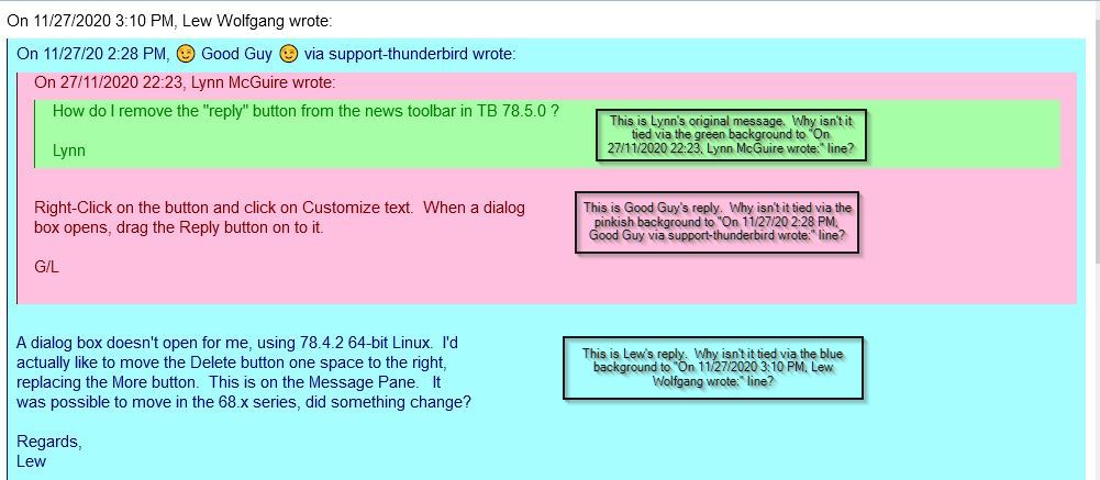

    Please, give the following information:
    • Thunderbird version: 78.5.0
    • Operating system + version: Windows 10 2004
    • Version of the add-on: 2.0.5
    I am brand new to this plugin. I really like it, but I have a question.
    When I select the option to use background colors for the different levels of quotes, it seems to link the quote to the wrong line describing who made the quote.
    I have attached an example, with added comments about why it looks strange to me.
    Is this the way it is supposed to work? I hope I am clear enough.
    Thanks,
    Bill
