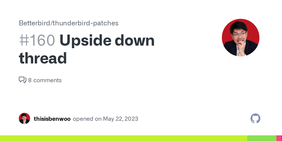

    Also, "tread tree reversed" ist hier vermerkt:
    Upside down thread · Issue #160 · Betterbird/thunderbird-patches
    Hi All, I've been trying all sort of things, as well as various extensions. If you take a look at the following: You can see that the latest email in the…
