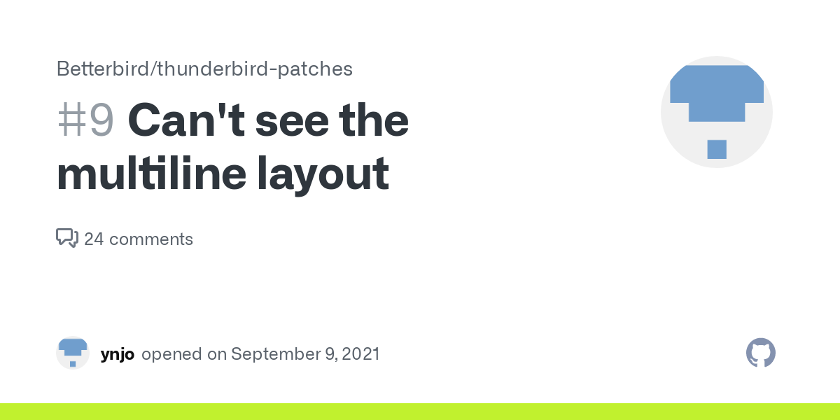

    "Body preview" in der dritten Zeile ist leider nicht möglich, siehe:
    Can't see the multiline layout · Issue #9 · Betterbird/thunderbird-patches
    Hello, I installed the multine preview, but in the vertical layout I still see one line per message. Is there a way to activate the multiline view? Thanks!
    github.com

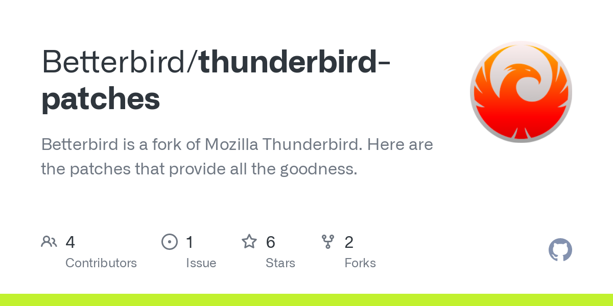

    Hab schon mal angefangen:
    thunderbird-patches/1562737-body-search-encrypted.patch at main · Betterbird/thunderbird-patches
    Betterbird is a fork of Mozilla Thunderbird. Here are the patches that provide all the goodness. - thunderbird-patches/1562737-body-search-encrypted.patch at…
    github.com
