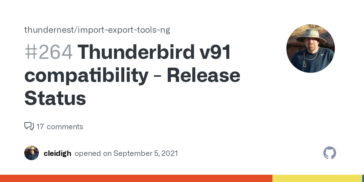

    Thunderbird v91 compatibility - Release Status · Issue #264 · thundernest/import-export-tools-ng
    Beta Releases v10.1.0-b1 basic support for Thunderbird 91 converted options screen updated WindowListener API v10.1.0-b3.zip fixed #266 fixed #259…
    github.com
